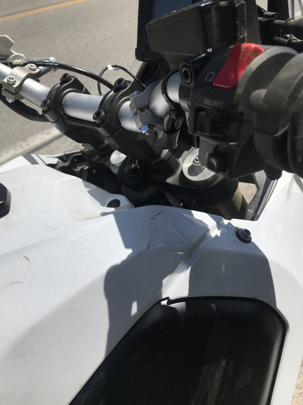

I've dropped the bike twice off road, one in sand, and the second, front tire hit a rock, deflected me into a tree, barbusters hit the tree, then dropped the bike on its left side. The sand one, resulted in no damage. The tree one, handlebars bent at the triple clams and the barkbusters bent backwards denting the top tank, exhaust got gushed and dented the swing arm.
What to learn from those: Tighten your barkbusters well, get rid of the low oem pipe.

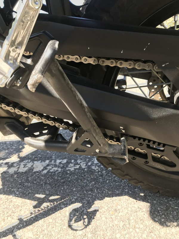

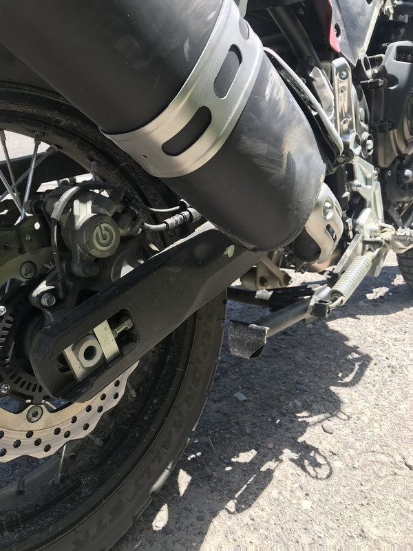

I took a left turn into a corner, not fast, a 2nd gear, 30-40kp/h turn. Leaned the bike too low, I think I hit the center stand tab, or the foot peg, one of those first, which lifted the rear wheel sending the bike into a slide. The bike did a full 180 turn sliding down the road, pivoting on the centre stand foot tab.

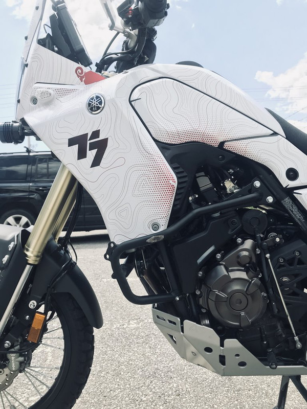

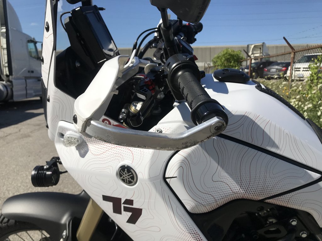

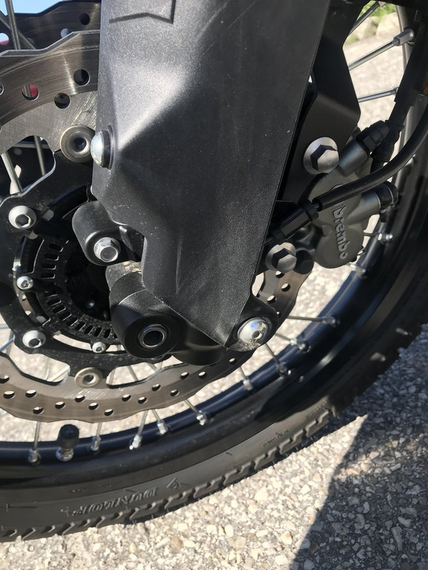

barkbusters worked as expected, in fact the lowside was almost exactly the same as the OM test video, just on tarmac. The lower bars worked great, albeit grinded off a bit. Center stand moved up, and into the swing arm. I think the centre stand is slightly bent now, hard to tell, no wonder Yamaha built that thing like a tank. Oh, and the front fender bolt bent, thankfully didn't break like many reports! Pivot Pegz held great.
What to learn from this: Don't go too low on the centre stand side, it may catch. change front lower fork bolts to nylon ones asap.
