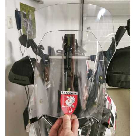

I also used the MRA screen but it wasn't enough. I'm about 185cm tall. I'm now using the big one from skidmarx. Took about a month to get made and shipped. Buffeting is much better as the screen is wider. Wind is just hitting the top part of my helmet. But the wind passes the sides of my helmet so i've got much less wind noise and having my head bob around in the turbulence.
For touring long distances i'll probably add some clip on screen i can remove once i'm where i want to be.
Just thought i might share this.
yamaha-700-tenere-2019-450cm-super-tall-
This is our super Tall Flip-up Screen made from 4mm acrylic to give extra strength.

So, ended up scrapping (not actually, just not using them) all my aftermarket screens and went back to stock, and better earplugs. My buffeting was largely acoustic in nature, not pushing me around on the seat. I did the 'behind the screen' visor mod, and am running without risers. Acoustic noise is still there, but no more buffeting. Also switched from my GT-Air to my Klim Krios and that made a huge different as well. Always liked my Shoei's but on this bike they don't like the air flow. The Krios does NOT move on this bike.
