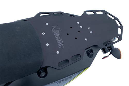

I got the Black Dog Helipad that replaces the passenger seat. Perfect platform for strapping the R80 to it. No permanent rear rack needed. When you don’t want it or the R80 just put the passenger seat back on

@Liquidape how does that Helo Pad mount? Just screwed in or is there some type of quick-release to pull it off?
You put it on and take it off just like you do the passenger seat with the bikes key. It has hooks that match those of the passenger seat and a post that clicks into the latch for the passenger seat.
Easy Peasy.

I meant the luggage rack/plate/helo pad. I do have their skid plate on my bike now though and it is good. Haven't seen many reviews of the T7 one though.

I have one of the Helo-pad racks for sale. Let me know if anyone needs one.  Photo available.
I run the Reckless 80 with the Blackdog Helo-pad.  Perfect combo. Searched for a long time for the right rack.  The only other one I'd consider, which wasn't available back when I bought my Helo-pad, is Camel ADV's new rear rack.
