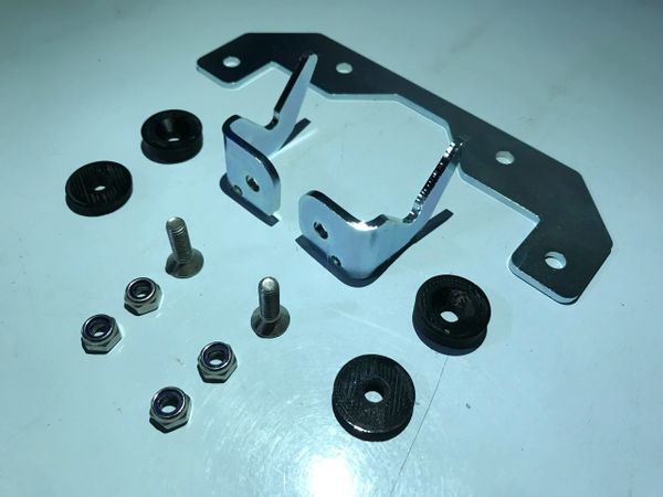

rs=w:600,h:600
Seat Joining Kit to solve the issue of the forward seat being bolted down, allows for very easy access to get to maintenance items.All parts are included in the kit, and no permanent modifications or cuts are required so its just...
this worked great (albeit a long delivery tme)
On 3/3/2023 at 6:02 PM, john_aero said:
rs=w:600,h:600
No, I don't want to join the seats, I want to be able to remove the front seat without having to remove the rear first.  That mod kit above is unnecessary because all you have to do is reverse the bolts that hold the front seat down and it pops straight off, but only after the rear is removed.  look at the mod, it's a lot easier to remove the two seats than one single long seat.
i have seen that mod but what I wanted to do was install 1 long seat cover for comfort onto of this seat. then it removes all rides or gaps for comford
