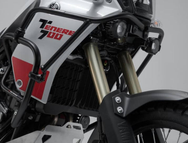

Then this
1_1_1cc80d67-c44d-4eb7-9b56-c9e8ea553aeb
SW Motech Upper Crash Bar for 2019- Yamaha Tenere 700 Made to match the motorcycle model, the crash bars are offered with weather- and...
Free shipping too, However ive heard it used to be great untill it got bad, is it true?

My bad, it is the outback motortek that ive heard some bad thing, now the sw motech.
This site had by far the cheapeast sw motech for canadian that ive found, ive bite the dust and ordered them. 🙂
