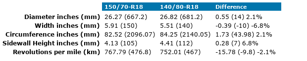

Soooooo...other than the cost.....what is the benefit of either? See percentages but what does the riding characteristics change?
The reason I ask is I have a 140 Pirelli MT21 Rallycross almost new that came on my 690 that was thinking of putting on the Tenere.
Edited by johnnygolucky
Knowing both are radial tires, smaller the side wall the less the flex from the rubber.
140 will have less contact patch compare to 150 due to physical width.
140 will have more rotational moment which will cause the tire wants to spin more after it has been going, but typically smaller wheel will have less mass....so might be a moot point with this comparison...
personally, I can see myself using 150 if I want to roll on highway more so than dirt.
my 2 cents
Edited by TimmyTheHog
So 150 road. 140 dirt? My 140 on the KTM did great on the road, and dirt. Almost same HP. Ktm 100 lbs lighter though.
If 140 isn't a big deal on this bike, and still handles the road fine I see no disadvantage to saving almost half on a 140 rear tire.
I have read that the 150's are built a lot heavier and more robust than 140's because they are built to with stand big weight and big power of GS's S10's big KTMs etc and that is why they cost a lot more. No clue if this factual or not.

Yes, 150 for road warriors. Because it is wider.
Yes, 140 dirt. Because it is taller, has taller sidewalls, more flex, more to air down,  less pinch flats.
They are more because they are harder to find. They are gaining in popularity as more factories use them as a stock size, but 140's are more prevalent.

Depends on the tire manufacturer as-well, the Dunlop Missions in 140 or 150 both have the same load/high speed rating and tread
One other minor tidbit is the 140/80/18 will effectively “gear your bike up” over the 150/70/18 just a little bit. Kinda like subtracting a tooth from the rear sprocket.
I did a change like this to a 2017 Honda CRF250L- their was a tire i really wanted to try but it only came in a different size than the manufacturers spec and similar to the comparison in this thread.  After installing it i also needed to add 2 teeth to the rear sprocket to offset its taller size. Then all was well.
Haven't noticed any difference in height or gearing with the DTM 140 rear. Doesn't make any more difference than running a tire with new tread, vs worn out
